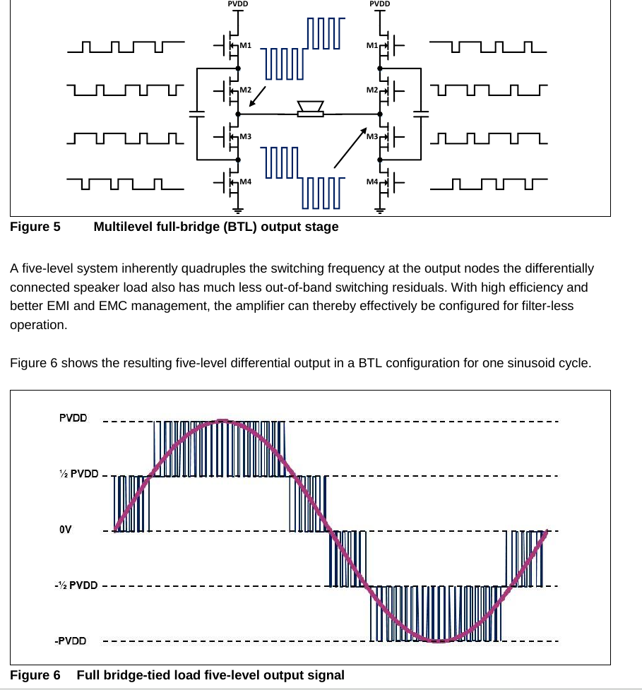

neuer d-amp , 5-level design
Infineon macht mal was Neues: multi-level-d-amp chips... by Merus Audio’s Ultra-Efficient eximo switching amplifier technology. [/font][/size][/color]
https://www.edomtech.com/en/product/ins....dex_id=114
https://www.infineon.com/cms/de/product/...ifier-ics/
https://www.infineon.com/cms/de/product/...s/ma12040/
zb
https://www.infineon.com/dgdl/Infineon-M...50002861a5
